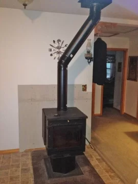

Well heres a pic of the installed stove. Half inch concrete board with 1" airspace between it and the wall. Gona go thru the roof with triple wall this weekend.

It's looking real good.
Congratulations. Pretty soon it will have fire in it's belly. Keep us posted.
I'm curious about why the wall shield behind the unit? What is the clearance to the wall requirement and how much is there in your installation?
The wall shield was for the insurance company. They go by some antiquated specs. For old smoke dragons. They would let me go 12" clearance with the wall protection. I told em englander say 7.5" with no protection. But they didnt care.
That is completely wrong. I would complain to the company that their auditor needs education or replacing or they do as an insurance company. Are you going to tile the cement board?
Yeah. It and build a matching hearth. But thatll be next summers project. I complained but to no avail. But until last winter, when i discovered this site, i was still burning like my grand parents. And cutting wood in the summer to burn in the winter. Burning smoldering fires with little heat.
Well, there is no harm for having extra protection and it will look great tiled. Still, forcing a homeowner to push a stove with good clearances further into the room rubs me wrong.
It did me too.
Well its all installed. Im workin on getting my wood ahead three seasons. Now just waiting on cool weather. Want to tell everyone thanks for the info/help.
