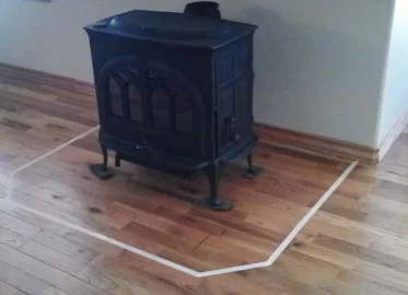

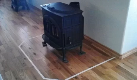

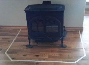

Hey Guys, Still trying to make it work...Take a look at this placement of my Jotul 600 and tell me if this might work...The manual clearances with double wall stove pipe and a rear heat shield is 8" from a combustible wall (shown in the picture)...if I place the stove there I have about a 10 or 11 inch offset to reconnect the double wall stove pipe to my existing chimney pipe directly over the stove...is there any problem with it offsetting over the stove?...(I have 10' ceilings in the room)...and would two 45 close clearance elbows get me the 10" offset or would I need a short piece of pipe between them?...the closest furniture to the stove is the end of a leather couch about 48" from the front corner of the stove...the taped off area is where the hearth would extend...any suggestions?...I can't place the stove directly under my existing hole because it places the stove and hearth too far out into the room's traffic pattern and too close to furniture etc...
thanks,
Ron

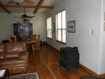

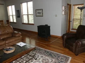

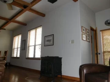

Gotta be a way Ron. Gotta be a way. Back way the heck back and get a pic from stove to ceiling and let's figure this out.

Offsets are common with replacement stoves. We have one too. Show us the big picture with some wider shots. This looks like it could work. Though I would make the hearth a bit wider and not center the stove on the hearth. Allow extra hearth on the side-door side.

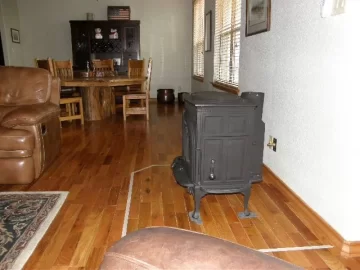

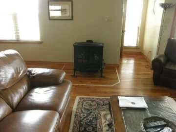

San Marcos is only 25 mi away...Here are some more pics of the room...My house floor plan is "upside/down" meaning the master bedroom and bath, living room, dining room, kitchen, entry way, and a big stairwell heading downstairs is located on the 2nd floor...this gives us a great view of the lake we live near...the stove room is all open about 30' x 30' with 3 big ceiling fans to move the warm air around...combine the other rooms upstairs it's about 1500 sq feet that the stove heats...downstairs is guest bedrooms, bath, mechanical room and garage...we usually don't heat the downstairs unless we have guests...use electric heat for that...
If it was left up to me that bad boy would be way out in the room but the "boss" says no...she likes the stove centered on a hearth and does not want the hearth to extend too far on the right side that would impede the walkway to the half bath which is located right behind the stove...I can probably extend the right side of the hearth a couple more inches...
The hearth will be 3/4" plywood with 1" of duorock cement board with slate tile on top...
Well, think this will fly?
Ron

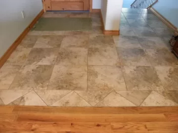

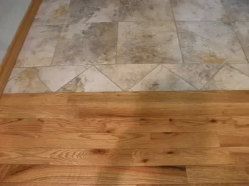

Nice looking place you have there. What kind of flooring is that and what's underneath it? Can you cut it out and sink the hearth down so it's level with the floor? That way there won't be any stubbed toes trying to go around the elevated hearth.
Thanks Todd, Great minds think alike...I would have to send my wife away for a few days...it just about killed her when I cut a hole in the ceiling and roof for the chimney pipe...The flooring is red oak...not sure of the thickness or what's underneath it...I guess I could cut a test hole in the middle of the pad to see what's underneath...I think it would look great if doable...attached are a couple of pics of my entryway...I like that look...
thanks,
Ron
  • [Hearth.com] 1st Time Post with Jotul 600 Question
There ya go, the same tile would be a great match and look for your hearth.

I don't see a problem with an offset. For a visual, take a look-see at some of the installations in the perfect picture section of the forum. Offsets are quite common. Also, based on the open room you have the stove setting in - it looks great and ought to get heating done easily.
Good luck,
Bill

Tell sis not to worry...think it's gonna work...
