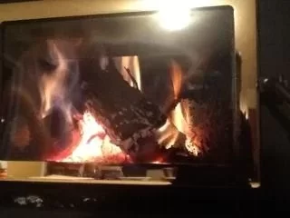

    Claybe can you walk us through step by step on how you're running the stove? Where is the stove is installed, chimney set up(size, height, turns etc), when was the wood c/s/s, stove top temps you're seeing, pipe temps along with how full you're loading the stove. When we talk about a loaded stove we're talking about full loads similar to the picture below.

    Nope, freestanding stoves have actual numbers. When your stove is cold what "dot" do you hear the t-stat flapper close at also what "dot" does the stove go from flames to no flames on a hot stove? If you can't load it like the picture above you'll never get the max burn times out of the stove. With your stove at 300-400 degrees does the basement cool or does the temp hold steady?
    I really think the biggest issue is you have a high heat load due to the basement install. My stove with a 400+ stove top will add heat to my nearly 2000 sq' house when it's in the low 20's. We had mid 20 temps all day with the winds blowing and I've ran the stove at 350* all day long and held the house steady in the low 70's. With a basement install you're probably never going to get the benefits of a low/long cat burn. If I ran a 600* stove top for any amount of time I would be run out of here.
    If I was installing a stove in the basement and trying to heat the whole house I would have a big honkin' steel non cat stove. To me the benefit of a cat stove is the low burn, something that doesn't get used much in a typical basement install. If the basement is fully insulated and the only space you want to heat a cat stove may be a benefit.

    Why can't you stack like Rdust's picture? That's how it is done. What's stopping you?
    Your cat probe is not a clock and has no hour hands. Describe what you mean with more universal terms. Is the cat probe indicating 50% of the active range?
    The firebox should not be flaming like that if you want a long burn. When you turn the stove down until those flames fo away, your cat would normally be glowing for the first hour at least.

    There are too many coals to stack like rdust. The probe is a circle. Imagine it like a clock and you will understand what I referenced.

    Okay the coals are almost all burned out and this is where I am starting at 2:00 mst.

    UPDATE: It is 3 and 1/2 hours later and this is how it looks. I have the tsat on the 4th dot and stove top is at 500 degrees and the basement is at 72 degrees and up stairs is at 67 degrees. I don't think this is going to work. I think I am going to have to move the stove upstairs as we don't spend much time in the basement. Now I have to run a liner and a cap upstairs. Uuuggghhhh.

    How big is the basement space, space above the stove and is it fully insulated? Try burning a few loads through it keeping the basement temps up the best you can, if you can get everything warmed up you may have better luck with the next load. I know you're needing to burn pretty hot if you have flames after 3 1/2 hours mine is lights out after about a half hour when I dial it down. I may see a flicker of flames every now and than but not often.
    Not counting the Alaska guys a basement install with a normal cat stove is a tough task. If you do move the stove upstairs I expect you'll be a lot happier. Most the time when someone is thinking about a basement install we try to persade the user to put the stove where they spend the most time. If it's the basement that's fine but results vary on how well it works to heat the rest of the house.

    That's a good load. If your stat is set at about 50% then you should be making some major heat. 500 stove top temps are pretty low, I easily bump into the mid 600s with a load like that and 50% throttle.
    I still wonder about the strong draft from that super long chimney.
