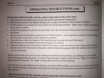

It’s been at least three years since I opened my BK manual, but I was sure it said to run every single load for 20-30 minutes on high after closing the bypass, not just once per week.
Mortimer would you like to make wager?
great movie, don't know if it'd be a sound bet though, manuals seem to change often.
Great movie. Don't be using that antique Princes manual, tho. Here's something more current. :p
Maybe BK has changed their procedure, but check the reloading section on your manual to see if it's different. See step 7 in my manuals:
