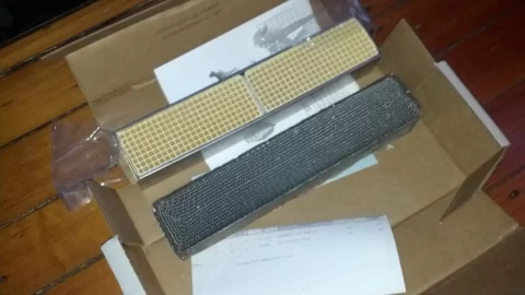

Well, I got a present in the mail from Condar today! But with temps in the 50s and projected to stay mild all week I dont get the chance to test it.
On the bright side with mild weather and a cold stove it was easy to swap out:) SS cat looks in good condition visually but back it goes.
Heres hoping no more stalls and smoke with the new one

I certainly hope so guys...2 problematic stainless cats in 4 years, if switching back to ceramic makes all the problems go away I will be thrilled... Right after I scream and punch a hole in the wall ;)

It was mild last week and the wife and I got away for a weekend without the kids in Boston, but today when I got back it was in the low 30s so I fired her up to try out the new ceramic cat with a small load. Right now Im waiting on a reload to heat up.
Observations:
  • Lightoff is more sluggish than steel (expected)
  • -After it lights, the probe temp climbs slower. Wheras the steel would shoot to 1100 in a minute or two the ceramic takes 5min+ to slowly climb to 900, then very slow rise to 1000+
  • By the time the probe got to 800 or so there was minimal visible smoke outside (big improvement vs. steel)
I'll need more time to know for sure and have to relearn my habits a bit but the first fire is definately promising. The slower lightoff is a small tradeoff for having smoke free stack at much lower temps than the steel, and the slower rise in temp might be a sign that this is going to be more controllable and less prone to runaway.. ??
