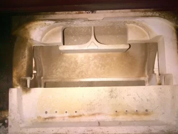

What do you think about the durability of the hard cast refractory so far ? The one concern Ive heard about these models is getting cracks if you hamfirst the wood in there...

The cast refractory is light years a head of the soft refractory from the 1945. It is so thick and heavy that I would have to really smash a piece of wood or a poker into the front of it to get it to brake.
