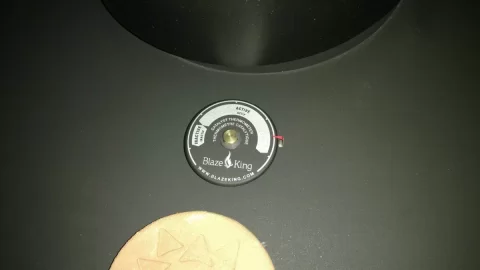

Anyone else have their cat run this high?
That's normal, mine stays higher than that for hrs before start dropping. Normal cruise in low is about 2 o'clock. I always do a hot burn after reload and it goes pass the scale. BKVP said that as long is into the active zone, is all what matters.
If that were true then you could open the door and smoke wouldn’t pour out. The pipe is under low pressure but the firebox isn’t always.
@Ashful said it spot on. I’ll just add that a pressure differential of .05 Is huge but what ashful was getting at is when the door is open the pressure differential between outside the stove and inside is almost the same with a slight drop near the top of bypass (assuming open) where the flue is drawing.
In order to maintain the same pressure drop with the door open you would need somewhere in the neighborhood of a leaf blower connected to the top of the chimney.
