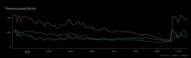

Looking for input--would you consider this TOO low? Its not a problem to burn a little hotter, but on mild days, I don't NEED it.
Here's an example with 8 hrs of data about 12 hours into a moderate load that could go ~16-18:

What are you using for data logging? The Cat line is surprising?
It is a home-made setup with a k-type thermocouple in the standard cat temp probe spot on the Ashford. Stack temp is a probe in ~midstream in the 6" stovepipe, ~28" above the collar.
Logging data via wifi to io.Adafruit.com for plotting and remote checking. I have a 'remote' display in the livingroom too. Details here if you're interested: https://www.hearth.com/talk/threads...h-wifi-remote-display-and-datalogging.170402/
That cycling between 600/700 and 900/1100 is normal for my cat when i turn it down lower for a long cruise.
It cycles less dramatically when run hotter and/or with my boxfan blowing harder across the stove.
Here's a 24-hr plot that shows more cycling from a different burn....

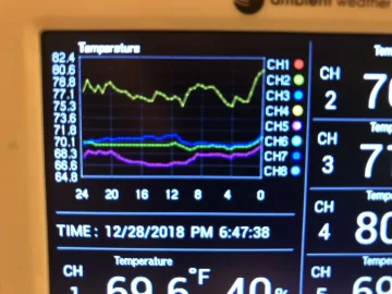

Thought I would also share my room temp report graph for the last 24 hours. Top line is the room with the stove in it. Seems to be running pretty long and smooth.
