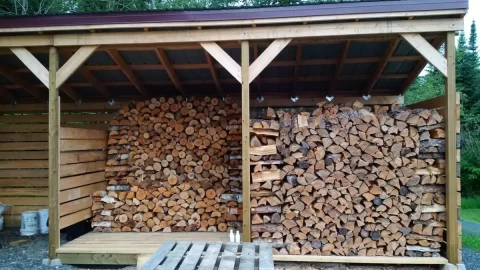

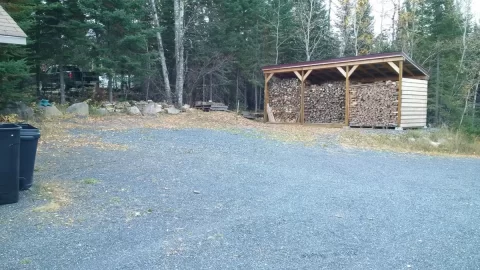

So here's a few pics of getting the wood shed initially loaded up with wood. In the one 134329.jpg, i'm half way through that outside face of Manitoba maple, and have dug back two rows to get into the jack pine that comprises most of that stall. Took some MC readings on some fresh splits that i brought in from the middle of the pile, where i'm sure the "least" amount of drying happens, and those jack pines are all between 13.4-15.3% MC, on the biggest hunks i have. So i'm pretty happy with that, and so's the stove! In that other picture, you can see all the birch I got - that stuff has been seasoning since the summer of 2016, and although it's buried behind a couple of rows of jack pine and Manitoba maple, i've dug a few splits out and they are around 15-16% too! So, although i budget only 1 stall/winter, I do have 2/3 stalls available for burning this year if need be! All my wood goes straight into the shed once processed, and doesn't see any sun really. But there sure is a good breeze that blows through it. Seems to be working just fine!

Will you need doors on the shed to keep all the snow out?!;lol;lol
you mean the snow that started falling Oct. 2? Yup, you betcha. I got some cheap doors also know as $3 tarps that i hang for the winter. Not very pretty to look at, but the shed faces east (out of necessity when deciding where i could actually build the darn thing), and so if i didn't cover the open face, it would be full of snow and driving rain, and i'd be hooped!
