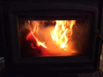

58 seconds after reload - i think my wood is good. Really enjoy the load and go of this stove.
