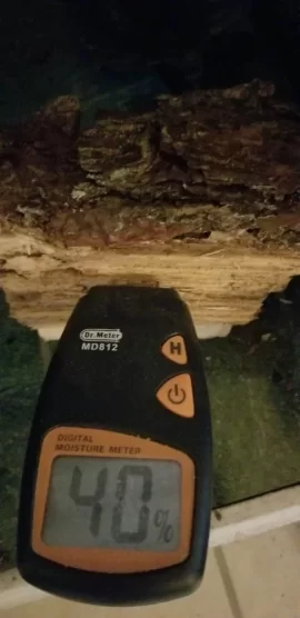

Here's a little odd from the last haul that has been sitting by the stove for maybe 24 hours.
[Hearth.com] 2018-19 Blaze King Performance Thread Part 1 (Everything BK)
That little chunk that has been sitting by the stove is quite a bit drier than the bigger stuff that the stove is happily eating.
Do you find it keeping wood close by the stove for a day or two helps lowering MC of the wood 2-3 %?
I don't know about that, but it definitely reduces the surface moisture and helps it catch more easily.
I suppose small/thin splits might dry out a little in the middle, but probably not a whole ton.
The difference in moisture at the very surface of the wood is large after a day by the stove.
