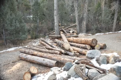

I'll tell this story here because only wood addicts find such stories even slightly interesting...LOL
The early snows up north have shut down the logging for the season here in CO. I placed an order in for a load of logs in late September. @ the time, the mill had a HUGE pile of logs from a 120 acre timber sale...and I was told it would be a month before they could get it delivered. Waited....waited more....called after 6 weeks...was told "it's coming...we just need to fill the truck again".... then another call a week later we heard "Sorry...we skipped over you and helped some other folks who were OUT of wood but it is coming...probably next week" (WTF?)....then...more silence. I shovelled the snow off the driveway twice in wait...still nothing.
Got tired of getting ganked and being held hostage by piss poor business practices...so found another guy. Come to find out...the original log guy I ordered from is out of logs and was trying to buy from the same guy I bought from...and even tried to undercut the guy from the set price they agreed upon when he brought a load of logs up. Crazy how things work out there and how some folks do "business".
Anyway....got the logs. It's a good load. The only funny part about it is that when he got here I found out the guy didn't have a dump bed....so I stood...in amazement...and watched as he pulled out a Stihl with..geez...musta been a 36" bar on it (probably small stuff for the PNW/Cali/etc but this was the biggest saw I've ever seen around here)....jumped up on the truck...and started wailing away. The bigger logs were on top. He cut em in half....grabbed an end...stood the f'er up....and bounced 'em off the back of the truck onto the ground. Made a bit of a mess of about half of the load......LOL...but it'll all cut the same. My back waas going into spasms just watching. It was nuts. Glad that guy wasn't pissed AT ME....
Someone took out a BK Princess? Blasphemous stuff right there! Enjoy those overnight reloads is all I can say... Wow. Makes no sense here (with 3 Princesses all firing and keeping shat nice and warm). Nothing surprises me these days though....LOL. (cues circus music)
10 chains all sharpened and ready to rip....should be some good fun
be well all
You have 3 of these things running?! No wonder you get logs delivered. Chopping those up should keep you warm.
Like I said above...I honestly didn't need the wood...but I'm sure some folks here know how that is. I did a couple of tanks worth of work today on the pile...will do the same tomorrow and burn through a tank on the splitter as well. After that..I'll tarp it all and deal with it when the snow melts in the Spring.
This is also the first time in 3 seasons of burning Oct-May that I've purchased any wood whatsoever. We have no other permanent heat sources in any of these structures....so there's no back up heater/etc. kickin in around here! Wood is all we do. I'm makin these babies pay themselves off but quick. LOL. The gas man hates us. I always wave when he goes by.
3 stoves....YES.....but my house stove is the only stove firing 24/7. I just try to keep the garage "warm" unless I'm heading down to do a project/etc...so unless it's super cold that stove doesn't see huge/full loads regularly. The garage is R-19 walls and R-30+ ceilings so a fire every other day keeps it 50F.
Ditto the stove for the dome. This structure's mass and daily solar gain carry it through most nights >without< any additional heat. (stays 20-25 degrees warmer than the outside air temps) I only fire this stove when it appears it will drop below 15F. Last night it was 6F so she got a full load. The dome stayed low 50's all night and finally bottomed out @ 48F this AM. The Princess is in an insulated 6 x 8 external shed...heat is forced into the dome air via an inlne fan on a digital thermostat with hi/low on/off settings. Just went out there...the shed is 100F...and the Princess is set @ about 2 o'clock with cottonwood in it. Later on it will get fed some oak to keep the glow going all night... I don't care what anyone says...the non-cat stoves just couldn't pull this one off. I'm dumping outside air into the shed and then sucking it across the top of the Princess and into the dome....and still...the Princess keeps up...for 12 hours on end....and "coals" all day. It was still 80F in there from last nights load when I went in to stoke tonight's fire.
