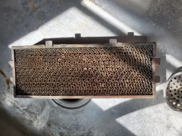

So is that sheet metal basically just a spring that wedges each edge of the cat? Or is a clip that catches a lip?
Just a spring that jams in the bottom and a short one up one side.
I originally planned to do four, one on each side, but 4 pieces of .030 sheet metal are .120" even if they are folded perfectly flat, and I was worried about thermal expansion clearances at that point. So it's just a horizontal and a vertical now.
When I retire this cat, I think I will braze the tabs to the steel case as a test run... probably have to cut the steel can open, remove the catalyst, do the brazing, and reassemble... I have a friend who has the gear to weld stainless too, so I might ask them to do it to any future cats. Brazing is no good with the cat inside the frame as you have to heat the frame up hot enough to flatten the wash coat, but I bet you could do a couple little tack welds without even cracking the can open.
