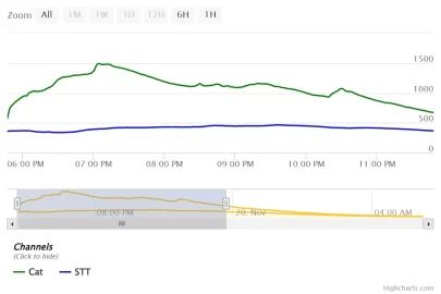

This is my burn from last night. This burn is pretty much how all my burns went through the weekend.
- I rake the coals more towards the back
- Load it about 3/4 full with mostly ash
- Once flue temp hits 650, maybe to 700, close the bypass.
- 100% air until the cat temps reach 950 to 1000 then close air to 50%.
(I did play a little bit with air at 60% versus air at 40%. I get higher cat peaks with the air at 40% (1600+) with a slightly longer burn than at 60% with cat peaks just about 1500 and somewhat shorter burns, exactly what I would expect . Now I'm just playing with slight variations to see what happens.)
I also measured draft periodically throughout the weekend. What I found is that my draft is typically .08 to .1 pretty consistently with flue temps under 700. With a flue temp of 715 the draft read 0.11 and with a flue temp of 780 the draft read .115.

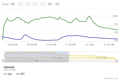

Very interesting burn this morning.... I took vacation this week so I have plenty of time to sit and tinker with the stove :)
  • A few coals left from overnight burn, raked them to back.
  • 3 med ash splits, <1/2 a load
  • Damper open, full air, let the load catch for a bit.
  • At 650 on the flue gas: engaged the cat, popped off and climbed.
  • At 1000 on the cat I started nudging air down, I did this in very small steps, maybe 5 "nudges" in 20 min down to ~ 30% air
  • Flames died away, orange glow only and occasionally I would get an "aurora" (a slow moving flame that spreads through the firebox then goes out)
  • Thought I had a real good burn going and then the gentle aurora turned more violent and I was getting back puffing of smoke from the griddle.
  • I closed my key damper to kill the draft and all seemed better for a 1 0minutes but then I started getting backpuffs coming from the secondary air inlet.
  • Opened the key damper and eventually got backpuffs from the griddle again.
  • Started closing down the key damper gradually and I was able to find a happy medium where no back puffing was occurring, but still getting gentle auroras. Draft measured at this point was 0.08-0.09 iwc.
The plots below are 2 second data, so you can see where the ignition events were occurring, you can see it in cat temps and flue temps as noise....
Interesting the correlation between where the smoke was coming out vs draft level.
- Low draft smoke comes out the secondary inlet and rises from behind the stove
- High draft and the smoke comes from the griddle gasket.

Burned some of my dry wood tonight instead of the NIELs logs, to have a change from the relatively mundane world of pressed sawdust.
I started the fire about an hour before dinner and added a bit over half a stove's worth of wood after the initial coals formed. That burned down over about 3.5 hours or so as I had turned the air down to a little under 50%. I did a smaller reload about 30 minutes ago on top of a large bed of coals that I had redistributed. The catalyst temp reached 1494 with the air at only 50% and it was still climbing slowly. Auroras (good name for those, by the way) rolling, subsiding, and reforming driving the temperature higher with each outburst. At that point I didn't really want to venture into higher temperatures so I opened the air to around 70% or so and temps started dropping again. It's been around 20 minutes and the cat has leveled out to around 1150.
Pretty similar experience to what I have been seeing.... Stove seems to run a lot different under 50% air. Sounds like you had a thick bed of coals, that may have been what was driving the cat up.

This burn surprised me. I did everything the same as I have the past few days but for whatever reason the cat barely broke 1000 (which is fine, just not typical) and this was the longest burn I have had to date. 10 hours later and there was a decent coal bed to work with. Air stayed at 50% for the entire burn. I would be ok with this kind of burn, just would like to see the STT a little higher; there were some pretty low dips in there.
yeah that's a weird one.... It happens.

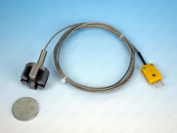

What are you using to measure STT? I know you have a TC but what kind? I am finding it hard to get a good STT reading, I am using a magnetic disk with a TC in the middle and it is reading low unless I insulate around it...
Looks like this.....
arnermd
Feeling the Heat
May 16, 2014
437
Tolland, CT
Yeah that's a better design, spring loaded. Difference is in the price.... mine was like $10, Auber is $60....
I may just make my own, I got some TC wire and magnets....

That's interesting about the auroras. When my cat gets high and those start firing off, it starts lowering my cat. I'm assuming it's burning off excess smoke and gasses built up towards the top of the firebox, reducing fuel for the cat. But yours was increasing the temperature.
Most of my burns will go north of 1400 for a short period of time and they don't typically 'level' off. I know others discuss their stove as peaking and then leveling off but mine is pretty consistently more of bell curve that gets up to temp quick and then slowly drops off the back end.
When the auroras were occurring during that burn the cat temp would increase slightly overall, the aurora would occur and the cat temp would fall slightly, and repeat the cycle. The cat temps after the aurora dips were higher than the previous incident - so an overall increasing trend.

I have this one from Auber. It reads, and has read, about 30 degrees cooler than IR gun. But, what is the margin of error for the IR gun?
View attachment 319131View attachment 319131
the cheap IR guns from amazon can be fairly accurate but depending on the surface some can be outright just so wrong it's incredible. Most of the time though people just dont know how to use them, and all IR guns have challenges w/ shiny objects to some degree. There's a distance to the surface that every thermometer should publish and you need to adhere to that, even if you see very little difference between 12" and 60" on a stove pipe, on other materials and temperatures it could be grossly inaccurate so for the best reading, read your manual and follow what it says.
I have a fluke, and they have a published page that shows you how to get the best results:
