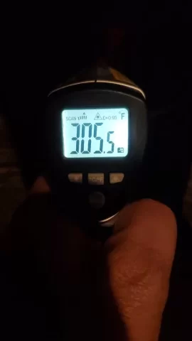

whats your opinion on the burn above
sorry about the picture above.. lots of glare..
I just restarted the stove.. here is what the coals looked like
put some small and medium splits on it and got the stove up to temp .. 552..and colsed the damper cat went to 900.. cut the air back to a little more then half way
draft was low..so around 900 will where it will be. stack temp probably around 300

So you have a bed of coals. You put a couple/few medium splits on the coals, which would burn bright and hot to get the stt back up to temp, correct? When those smaller splits get the stovetop up to temp you engage the cat to get the cat up to temp, correct? Once the cat is up to temp, you open the bypass back up, load up the stove, close the bypass and set the air where you want it?
@arnermd I told you last week I haven't had any back puffing happen that I'm aware of. Today it's been happening somewhat regularly. I have a brand new stove to learn based on last night's run away and today's back puffing. Good. I was getting bored.
yes.. to all of the questions.. you got it
is this any different then how your doing things..
Ohhh.... you actually open the bypass when the cat is hot and then load up? This is something I did not understand before.... I thought you let it burn down to coals and then loaded up....
When is the cat hot enough where you will open it and load up?
I am going to try that tonight....
