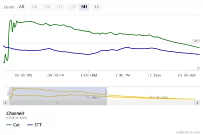

I finally got some draft readings tonight. I did force a fire tonight when it was too warm but, naturally, I couldn't wait to see what draft readings I would get.
I couldn't get the cat over 900. Did a couple rounds of opening the bypass to try and build the fire up but it just wasn't having it tonight. The goal wasn't to have a big fire on this warmer night, just something to see what the draft would be. The cat sat at about 850 for two hours. While it was steady around 850 the draft reading was .08-0.1
Now that I can get draft readings I'll be checking that more often.

Wow.... I think our stoves are in cahoots..... check this out.
  • Stove was cold so I did a pre-burn of 3 smaller splits, bypassed cat

This is the burn from last night.
- Three smaller splits, less than 1/2 a load
- Cat never went above 1000
- Eventually put the air down to 50% around 9:00am, probably didn't need too
- In the morning there was a decent piece of charred wood left, unfortunately.
- Before I engaged the cat the flue was 640 and the STT was 440 and the draft was 0.1.
- When it was cruising around 850 the draft was .08-.1 with the flue around 500.
Now that the temps have come down I should be able to burn more normal again. Hope to have a lot of data by the end of next weekend.
