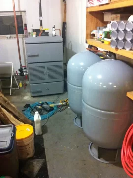

Effecta 60kw with pellet option 30kw
Been running pellets all winter, works great. At -40 plus for more than two days i have learned to switch to wood in the first 24 hours if it will stay that cold. Need the btus
At -20 the pellet gun work great heating 4800 sq ft.

Very nice!

Hey Morgan, just wondering - how is your pellet consumption, and how much do you pay for them way up there? I could see pellets being in my future - but hopefully not for quite a while yet. And hopefully by then the local supply situation will be better.
The pellet burner will keep up to -20 or so, if it is going to stay around -20 or colder for more than a couple days I make the switch to wood and get the 60KW output.
I have been away before and early in my testing and getting familiar with the system I ran pellets (30Kw) down to -40. Wanted to see how it would keep up.
Day 1 - no problem
Day 2 - noticed a one degree to two degree drop in the house
Day 3 - noticed significant drop of 5-6 degrees or more temp dependant
This was expected with my sq footage that is why I went dual fuel.
I have learned to make the switch early enough to not loose much in house or she starts to voice her opinion! Lol
-10 1- 1.5 bags
-20 2-2.25 bags
-30 3-4 bags
-40 5+
Just my testing nothing scientific to it, a ledger showing date and how many bags I loaded in my half ton hopper.
Regards,
Oh yeah
269 a ton
or 5.38 /#40 bag
