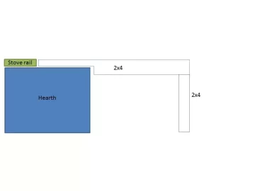

For those who have a home-made service rail kit for their 52i, did you cut down the boards so that they are the thickness of the metal rail that the stove sits on currently...or do you simply just lift the stove up onto the 2x4 and start rolling? See the picture below.

Thanks for posing the question! I'm about to make one for my 52i and had the same question you do. Some designs I have seen have the 2x4 butted up against your hearth but with a makeshift rail mounted on the top extended to butt up against flush with the stove frame rails, but I haven't figured out yet how to do that or where to get the materials.
I am thinking about going with my structure above but add a vertical piece close to the end of the heart to help support it there. Don't want this bad boy falling down due to broken 2x4s!

My stove rails allow for a 2x4 with a 3.5 "strip of laminate flooring attached so the stove slides better. I built a box the same height as the hearth and attached two 2x4s on either edge that extend to the stove.
Your stove rails are that thick? Wow, is this an older version? Mine aren't very tall at all
So I spent a good amount of my Sunday making this stupid box. It didn't work in the least bit. As soon as those rollers hit the soft pine 2x4 they sink right into the wood and it is IMPOSSIBLE to slide.
You people using 2x4's, either I don't believe you actually get this to slide on the wood and are lying, or you have metal on top of the wood, or you are using it as a platform that the stove gets lifted onto.
The older version of the Accentra insert doesn't use rollers, so it will slide on 2 x 4s. I added carpet strips onto the 2x4 stand I made and it slides much, much better. Not sure if something like that would work for the 52i version.
Well, this is a good lessons learned for others out there....if you have the 52i...buy the kit or make one of sheetmetal.
If you decide to make a kit...be VERY positive on the width of that thing through the entire length. There is very little tolerance for the rails to go wide and cause a big disaster.
