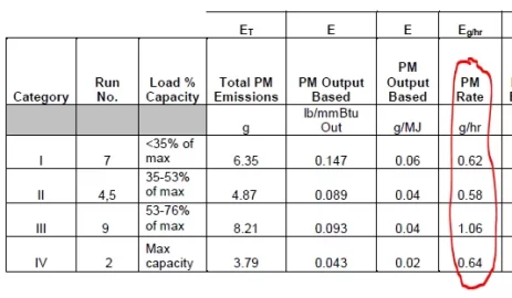

The GPH actually came right from Intertek's EPA test results, page 8: https://www.lamppakuuma.com/wp-content/uploads/2017/09/Vapor-Fire-100-EPA-test-report.pdf
Also on Page 26 of the owners manual. Pretty sure they HAD to add it per EPA requirements: https://www.lamppakuuma.com/wp-content/uploads/2017/03/Model_100_Manual_60525.pdf

I was drooling over the kuuma website and they DO list GPH now! Hot dog.
