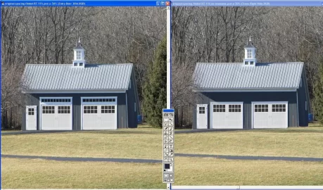

Existing barn, with a 30" entry door on far left, 9' wide overhead door on left and 10' wide overhead door on right:
[Hearth.com] Barn doors - cosmetic question

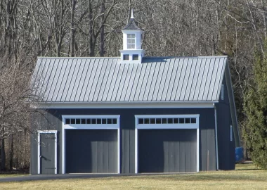

I need to remove transom lights and move the left overhead door about 3" closer to entry door. I also want to increase entry door from 30" to at least 32". Here's a mock-up in Photoshop:

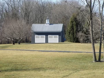

Because of the tight space between entry door and left overhead door, and the unequal sized overhead doors, I'm thinking of moving the entry door around to the side, and going with two 10' wide overhead doors. That would look something like this:
Better? Worse? Doesn't matter? It will cost me more to move that entry door, potentially create other havoc with framing and my floor plan, but I'll do it to keep the building from looking odd with unequal door sizes, etc.
Thoughts?

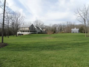

Setting / perspective:

Why are you wanting to do this?
I like how it is now personally.
Hah... yeah, I like it now, too! Those existing doors must be swapped out, and the transom windows eliminated, for a few reasons:

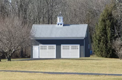

Here's a mock-up of the barn with all doors in original sizes and locations, both with and without transoms:
Do note that the left door (9-footer) will have to move about 3" closer to the entry door, no matter what. This is necessitated by a change in the structure inside the barn. For scale reference, that is about the width of the trim casing around the door. The transoms are uninsulated plexiglass, so they have to go. Besides, one has to move. I could replace them with double-pane transoms, if they really make the barn look that much better, but I'm really surprised people like them in combination with the lighted doors. Maybe I'm just too close to this project to be objective, tho.
