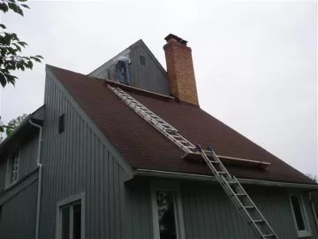

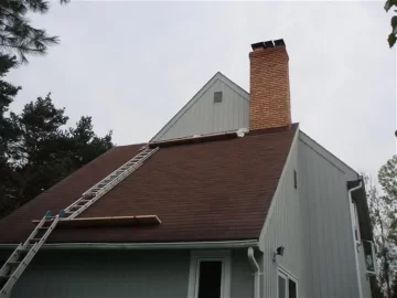

That was my thinking, I guess I'll see what the guy I have coming out tomorrow has to say. If he doesn't say what I want to hear I'll probably man up and do it myself. :) I usually wouldn't pay for this type of thing but I just want it done. With a 4 month old in the house my wife will kill me if I fall off the roof. lol
For reference here's an exterior picture of the chimney from when I was painting last year.
  • [Hearth.com] Best location for stove?(floor plan attached)
