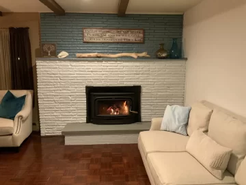

I posted this in another thread, but probably worth sharing with you. Here’s the black Ashford all set up and cooking some wood.

Looks good, did the captain talk you outta insulated liner? He laughed at me. “If we lived in Alaska maybe.”
I’m happy with mine, no 20 hr burn time but it’s definitely doing the heavy lifting as far as heating our 2000 sqft house.
Reactions: dafattkidd
Ha! Similar conversation. It’s a double wall liner. He’s a super knowledgeable guy and I liked his installers a lot.
