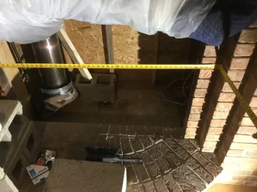

Yes it is a tear out. I’m in the process of knocking the brick out this weekend and have a bricklayer scheduled to lay a firebrick alcove in a couple weeks. The flue is 8”
What make/model fireplace is in there currently? Some fireplaces, especially some contractor grade units use a chimney pipe that is not the class A HT needed for a wood stove. Best to check that. Also, have you checked and compared the alcove clearance requirements for each stove to be sure they can be met in the alcove?
I called the manufacturer on the Sequoia alcove clearance. That’s the reason I’m going fire brick. I will meet the 8” clearance and 90+ for height. As for wood the property was logged 4 years back so I have lots of oak, ash, maple and have a lot of standing dead locust. I currently burn wood in the garage as sole heating source. I have plenty stacked and some for the past 2 years. I’m changing the flue to class A. What’s the best pipe to use? I’ve seen a couple different manufacturers. It will be going up a chase with 2x4 and osb brick exterior . The old unit used double wall 8” majestic. So it’s gotta come out. At least I’ll get to keep my cap!

Hmm, how much brickwork was intended to be pulled out? The view out the windows looks to be above grade. Is this area a basement?
I am wondering what is intended to be saved here? As mentioned earlier the chimney pipe may not be spec for a wood stove. One possible idea would be to have a mason just extend the hearth and put a rear vent stove on it connected to a liner up the chimney.
Actually the entire face, both sides to the drywall. There is a double joist each side for the header that was there for the last fireplace. After that comes out the top header will be tall enough for Sequoia clearance not sure on the BK. The flue, 30 degrees-now to the right corner and then up the chase. With new alcove I could then run new flue centered back and up. The old hearth I think makes everything to tight and is to narrow to meet any clearance. Trust me I don’t like the idea of all that being torn out $$ but if I don’t the stove would set out in the room somewhat in front of the stairs. It is the basement, its a walk out.
What is the distance between those supporting double joists on each side? That is the governing factor.
Before proceeding, carefully look at all options. This will be an expensive undertaking. I would not go by a verbal ok from Kuma. The manual says the stove needs 16" clearance to combustibles (with double-wall stove pipe) on each side and a 62" minimum alcove width to combustibles. Adding a brick veneer to the alcove sides does not change that requirement. If Kuma will provide a written document which provides a reduced clearance requirement that specifies the actual reduction and the wall shielding method that is required to reach that reduction, then it would be ok. Otherwise I would not go there. Same for any other stove maker. The BK King has a side shielding option which really helps reduce side clearance requirements. With side shields and fan kit this can be as low as 9", giving it a minimum alcove width of 51" to combustibles.
What is the distance from the current hearth front to the stairs?
Is that current structure supporting anything above or is it just decorative? If it is not structural just take it all out and don't mess with an alcove at all.

Agreed. The brickwork looks like all facade for the ZC. Having a plan view of that area with actual dimensions and the location of the nearby stairwell would help.

Center of stove to staircase is 8’6”. I’m guessing to new hearth to be approx 6’. It looks like BK is narrowing to the only possibility .
If taken out what do I put in its place? I looked at rear venting stoves and thought about putting a cover over the opening. However I haven’t found a stove that supplies the btu output i need.
It is all cosmetic not structural.
You dont put anything in its place other than drywall and run the pipe straight up to a support box for the new chimney.
I think he wants to keep the stove from protruding too much into the room and therefore to have the new support box and chimney still in the exterior bump out and chase. It may be possible to have the stove outside the chase alcove, but with an offset in the connector to the support box. This is much easier to do sitting down with a sketch that shows true dimensions and locations of the opening and the staircase.
Dewdog, it looks like the framing wood starts right after the brickwork opening. Can you post a picture of a plan view of this area with dimensions and maybe one that shows the stairs in relation to the existing hearth?
Begreen yes I’m trying to utilize the chase. The steps aren’t to close for sure being the basement door is between the two. However there would be a small walk around to it if it doesn’t recess back into chase. I also like having functionality to the pre- existing. If this were a 100yr old farm house I wouldn’t mind it. Only opinion but if I can’t utilize the chase it will look like I only went 50% or cut corners. And yes maybe I’m annal but it’s all opinion. If I can’t ill use the alternatives.
It looks like a 48" bump out for the old fireplace. If so, that is a typical width. I'm a little surprised the chase was not insulated.
You might want to consider a BK Princess Ultra for that space. it will just fit in a 48" alcove.
