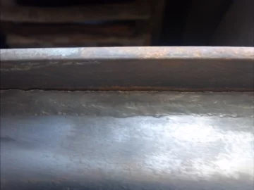

Have you inspected welds and such? This is the bottom of the door frame on my sister's King that I rescued for her. The entire length of the door was like that. No penetration into the frame.

It's not so much a test as more an inspection. Using a flashlight, please check for welds around each seam. For the burn times you are getting, this would not be a tiny missing weld....if there is one. Let me know if you have any questions at all. Have you asked the dealer to come take a look.

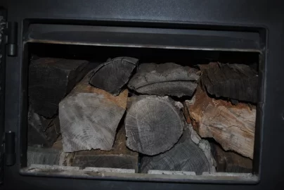

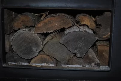

I've also noticed that the wood burns front to back. I load it completely side to side and the front will burn down way faster than the rear. I imagine this is because of the cat. Is this normal?
The air comes in the front so it's going to burn the wood in front first. I load n/s which is loading the pieces straight in, I have no interest reaching in a hot stove to load the back pieces.
I've attached a couple pictures to provide an example of a loaded Princess.
  • [Hearth.com] BK Princess need help
