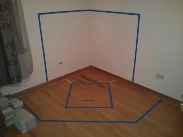

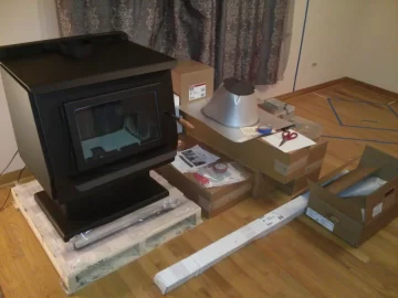

Ill burner, i wish you the best of luck with this situation. I also have a brand new BK princess ultra sitting in my living room along with some DVL stove pipe and a Duratech SS chimney waiting to be installed (pic below). Even though the stove only requires spark protection the wife still would like a stone hearth pad, so im in the process of planning that out. I'm also in Illinois and could not find a decent BK dealer, let alone any that had stoves in stock. Looking to avoid the long lead time and shipping costs I ended driving almost 3 hours to Indiana to pick up my gear from a great dealer. Its unfortunate they will be not be able to do a home visit if i have any issues.
