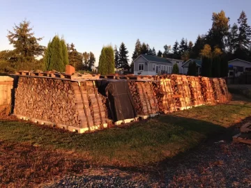

You just need to be organized. I keep two years plus. That is plenty of time for PNW species. Each little row is 1.25 cords. About 10 cords there.

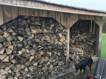

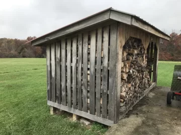

If you want to burn wood get creative
I built this wood shed at the last house. It holds just over 6 cords. Has a center dividing wall, each side holds a one year supply.
