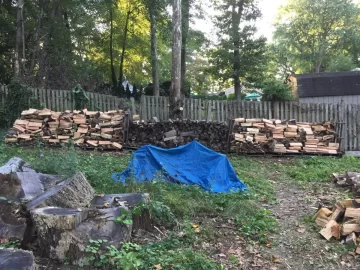

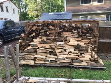

1/4 lot is plenty for 3years cords to store if you're serious about having dry wood. It can be stacked and/or covered in a manner that is not so unsightly.
Agreed. I have 1/2 acre lot and keep about 7 or 8 cords on hand and am actively seeking more. I stay about a year ahead. IMHO, while the 3 yr plan is ideal, 12 months of good drying time will be fine for most hardwood. Where it gets tricky is if you have oak or wood split on the big side-that will take longer. If you are only burning 1 cord a yr, you only need 3 cords or so. Not really taking up much more space. Here’s my stack on a warmer day. There are several rows behind the front row you see here.
