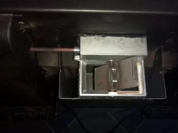

Does yours hit a stop at 6 o'clock? This is what mine looks like at wide open, 3.5. The collar on the shaft has an extra long set screw that also serves as a stop. It is fully closed at 1.5, with a stovetop temp of about 250. Thats about 2 o'clock, I know the Princess has a different thermostat and I don't know if the markings are the same. Perhaps something is out of adjustment, or something else is wrong with the thermostat? You should definitely have more of a range of operation.
  • [Hearth.com] BK T-stat question-
