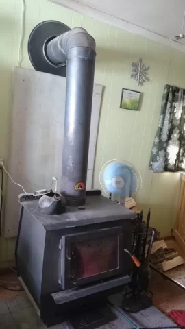

Well what species wood are you using and how long has it been split and stacked? Was it covered when stacked? And are you sure that is double wall connector pipe? It looks like single wall to me but i could be wrong
Yes it was stacked in a shed for a year and it is bull pine/yellow pine, the inside is single wall but the outside chimney is double wall.

That more than likely is single wall...ask Webby.
Also, I see the cat in the picture. It's stainless, so is that the one regasketed and inserted in the stove?
Open the loading door, open the by pass and take a picture of the opening where the by pass plate closes against a gasket. In order to burn that much fuel, 3 times a night, you have an issue...maybe more than one.

Nice catch by BKVP- there appears to be a steelcat sitting on the floor outside of the stove, which appears to be burning? Do you have two combustors for the stove?

Isn't the back of that stove on a wood floor and the wall protection about a foot off the floor? Could be just the pic and my eyes.
