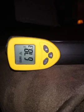

I honestly think something is wrong with the stove (he says half sarcastically - :)). Below are pictures of my combuster indicator and an infrared thermometer directed immediately adjacent to the indicator / on the surface of the stove. Seems WAAAAY too hot. This is ~ 45 minutes after lighting kindling/starting and running as follows: open damper/turn off combuster, turn thermostat on high, light kindling, load wood (largest splits) fully only after kindling established, close door, close damper only when gets in active zone, immediately lower thermostat to lowest possible setting (7 PM) and leave fan off.
I cannot imagine this is all because my chimney is 25-30 feet high! Minimum wind right now. Still rather vigourous flame. No smoke out of chimney.
Again . . . thanks for any help.
Tom
Tom

You have an air leak or a messed up thermostat/flapper. High draft doesn't explain what you have going on.
If you turn down the thermostat all the way, the fire should immediately look different, and the flames should be gone within a minute.
If you've tested the door gasket and the glass gasket, I am betting that the fault lies with the flapper or thermostat. Failing that, maybe someone drilled an extra hole in your stove with a forklift. ;lol
