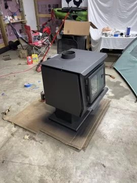

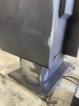

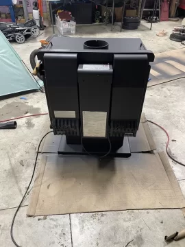

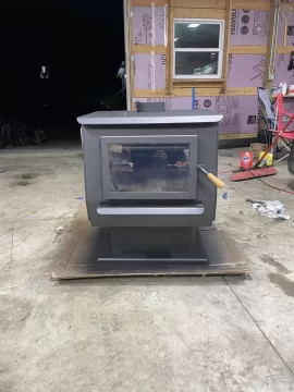

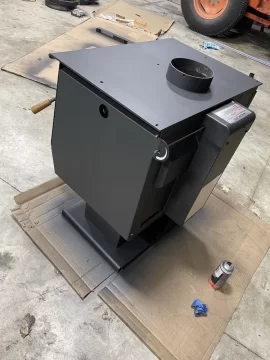

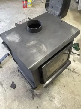

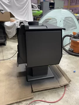

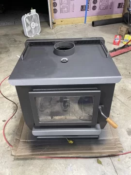

couple weeks ago I ran across a “blaze king stove” for sale about 3.5 hours from me for 400 bucks. Turned out to be a blaze king princess manufactured in November of 2016. The guy agreed to hold it for me and I made the drive to get it. Man was that drive worth it. This stove aside, from a few pitted rust spots turned out to be an amazing shape. Catalyst looks great and it pretty much came with all the extra bells and whistles BK offered with it. Including the ash drawer and blower fan.
I picked up some stove bright metallic black and after some sanding and elbow grease I put some new life into this ol girl. I plan to do the curing burn outside since it’s already in the barn. Can’t wait to get it installed and enjoy some long burns. Will be a much needed upgrade from my cheapo pleasant hearth, which at my most efficient could only achieve about a 6 hour uncontrolled burn.

Nice!
Note that the cat might be okay, but might not be. Looks don't say much. Look at what comes out of the chimney with and without the cat engaged.
Your chimney is tall enough?

Good point. At 400 bucks for the stove you won’t hear me complaining even if I do need to replace the cat. my chimney meets the 15ft minimum per the manual.
