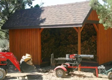

I don't think it makes much difference what you roof it with. It's ventilation that's important for seasoning (if that's what you're after), and protection from rain and snow/ice that are important for convenience in handling. I don't know where you live, so I've no idea what your snowload requirement is for roof construction. It has to be strong enough to withstand that, whatever it is. I built a shed, with a lot of help from my friends, that'll hold nearly 8 cords. Had to look nice, not to satisfy any architectural committe, but to satisfy me and my wife, as it sits pretty much right beside the house. The wood that goes into my shed has already seasoned outside elsewhere, so it just needs to stay nice and dry and snow/ice-free. Nonetheless, my shed is very well ventilated, from beneath and around all four sides. The roof is a standard built-up asphalt shingle deal. Rick
  • [Hearth.com] Building wood shed  Clear polycarb panel roofing
