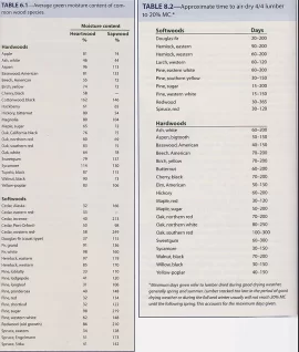

Unfortunately oaks are REALLY wet, red more so then white. Either way they're about the worst woods to be cutting last minute. I find when cutting standing dead the upper part of the tree is ready faster. I figure this is due to the moisture pooling up in the bottom of the tree?? Wood looses the majority of the moisture from then ends and when the tree is standing together there isn't much place for the water to go, when the tree looses it's bark you'll loose some that way.
Attached is a chart showing m/c of different woods, try to find types on the lower end when cutting in a pinch.

Very interesting. Looks like moisture content is only part of the picture. Density should be in those charts as well. Look at how high sycamore is for MC, but it is listed as one of the faster drying woods.
That chart caused a stir a while back when battenkiller (I think) posted it as the drying times for 4X4 lumber are some what low compared to drying times for fire wood.

I agree, I think density plays a big role. I cut some poplar standing dead last year(march 09) and it was soaking wet when I split it, it wasn't ready for last season but now it's light as a feather and below 20% m/c.

Yeah I remember that. I posted it more for a reference for starting m/c not so much for the drying time since most of us can prove the drying time wrong. :)

They pretty well covered themselves. Look at the 3X plus fudge factor for drying ash, 60-200 days or 10X+ for redwood at a whopping 30-365 days. Like I posted earlier, there are lots of variables in drying wood. That's why it's good to get at least a year ahead.

It says the reason for that was the timing of the year, if it went through the winter the drying time slowed way down compared to spring and fall.

<del> Something odd with that chart. Many of the wood species show more than 100% moisture content?????</del>
EDIT: Ignore... pre-coffee brain freeze. Forgot that moisture % = water weight/ wood weight.
