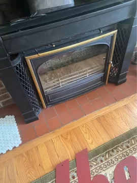

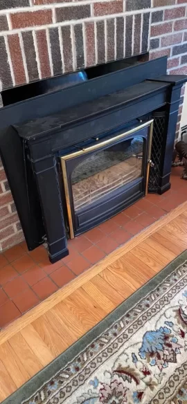

Can anyone identify this stove?
jdwalla
Jul 29, 2021
2
Raleigh, NC
Im currently in the market for my first wood stove insert, how exciting! After being quoted $6000 for a basic install I have been searching the used market and found this. The lady selling has no information on it so I'll leave it to the best:
Can anyone identify this stove?Can anyone identify this stove?
Vermont Castings Winterwarm. It's a complex stove and if it needs a rebuild it will be costly.
