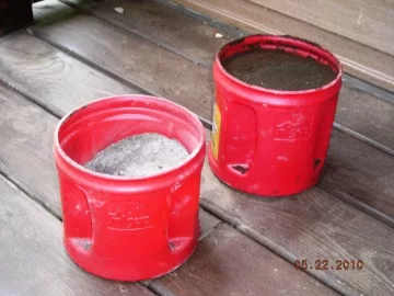

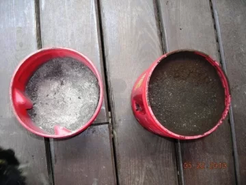

This was my first year with my insert with cleanings in January and last Saturday. The stove manual recommended twice the first year and as needed after that. I have 22' of SS pipe. The pictures show what I came up with on Saturday's cleaning. The cannisters were very feather light in weight and essentially all of it was fine, dust-like particles.
