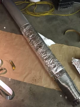

Oval insulated duraliner will fit those dimensions as described. It comes in solid and flexible sections for getting through the damper. The flex sections will need a insulation wrap. And various oval to round adaptors. I've used it on my own insert and it's high quality and works flawlessly. It's also handy if your chimney as short as you can extend out the top up to a length(no exposed connections). It's not cheap but it's high quality(IMO) insulated pipe, offering great performance and safety.
View attachment 220267 View attachment 220268 View attachment 220269 View attachment 220270
