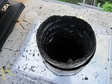

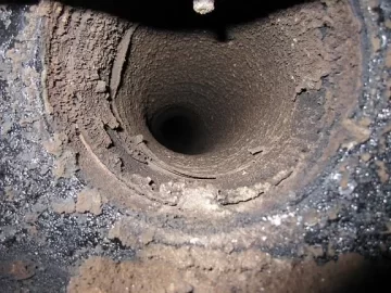

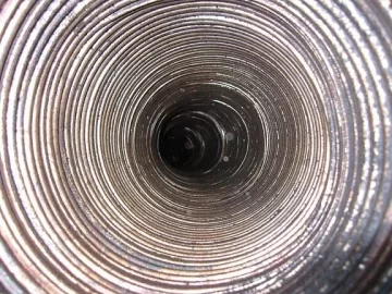

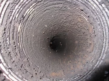

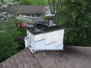

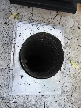

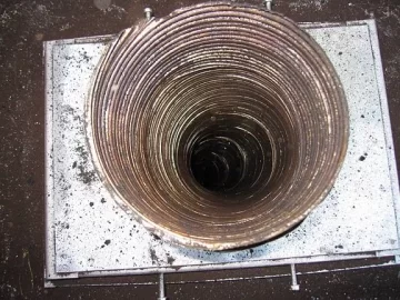

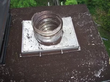

I just cleaned out the fireplace and swept the chimney. I also have a suggestion that I would like to share.

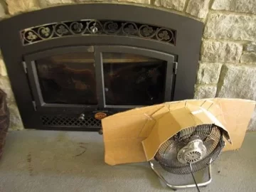

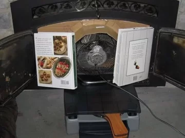

Once I have cleaned out the ash in the fireplace, I setup a cardboard baffle and fan. This is blowing air up the chimney.
When I am sweeping the chimney, it is blowing an awful lot of stuff up the chimney at me. So I wear coveralls , respirator, hat, safety glasses, and face shield (yes, its pretty silly looking). While sweeping it looks like the smoke monster from Lost. The light material gets blown out and the heavy stuff falls back down. This keeps the house nice and clean. I have done this for 4 years (5 sweeps) and have had no problems with material finding its way back inside.
Before and after pictures should be pretty self evident. Once on top of the roof the whole process took 10 min to do.

Great idea. Thanks for sharing and the good pictures.
Excellent! I like the fancy rigging for the fan too. :)
thanks for sharing. You would think that pipe would be hard to clean.
Is it a liner inside an existing tube.

Second; all that creosote on the roof is kind of a mess! I try to minimize the amount of ash and creosote that finds it's way onto the roof, it's very corrosive and that much would destroy my metal roof in no time at all.

No offense taken at all! I never had a problem doing it without the fan, but i have never done it without the fan, this just seemed logical. I have seen videos of profesionals that block off the fireplace and connect it to their vacuum. Since I didnt have a fancy fireplace hepa vacuum, this seemed like a easy alternative. So I have no idea if it is needed or anything, just how i do it. Well, I do this for 3 reasons
1) I know when the air control is shut, some air can still get by, not much, but some. I dont want any of the fine particulate back in my house. I also dont bother removing the baffle plate, so I really only want the heavy stuff that wont blow around coming back. (I removed the baffle plate once, after 2 years of burning and sweeping this way, and there wasnt anything to speak of on top, so I was happy.
2) When cleaning the remaining creosote that fell back into the house, it is pretty chunky and doesn't cause much dust, all the light particulate is up and out the stack.
3) I figure if I didnt do it this way, then the fine particulate would have to settle back somewhere, fireplace, or the ridges in the stack, the less I have the better.
That being said, this is all likely extra that isnt needed. I am sure just about no one bothers with this, they just close the air and have at it. But I figured why not, there was no cost in it and the setup for the fan takes 60 seconds. No harm done even if it doesnt help any. And the stuff on the roof is light and fluffy, it should blow away in a day or wash off at the next rain... at least that is my suspicion.

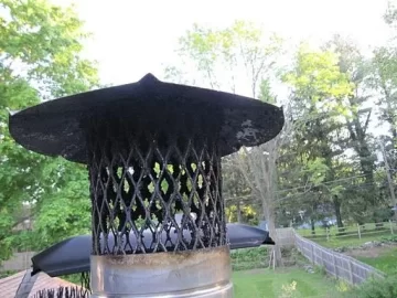

Nice job on the cleaning. Looks like mine, heavier buildup at the top going through the cap.
Yep, its a stainless steel liner inside a old terracotta stack. No insulation between the two, didnt know any better at the time. But the buildup levels I have gotten havent been anything to be worried about. I had the fireplace store install it with the new stove, it looked very easy for the guys to install.

PS I've got a new roof. The less that lands on my roof the better.

OK, only one question . . . if I opt to do this what is the title of the cookbook that I need to purchase to make this work correctly? ;) :)
