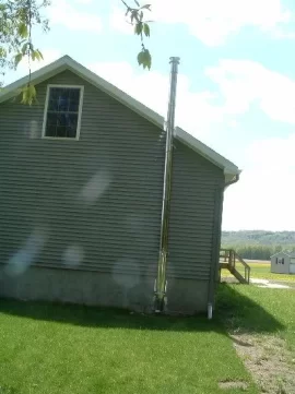

From the pic, it looks like you have a an attic of some sort & I assume you
can access the top of the chimney chase there. First thing I'd do is drop a
plumb line to verify that it lines up top to bottom.

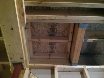

Here's what I'm working with in the basement ceiling:
[Hearth.com] Class A chimney install - how difficult?

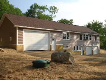

I dont know much about Class A chimnies, but wouldn't this be an easier way to go with a ranch?
It can be, but the straight shot up has always worked better for me than one with 2 90 degree turns.
Selkirk provided great instructions with their kit.
Reactions: Knots
Maybe, but the house was designed with a chase near the middle, so I'm going to use it. It puts the stove in the center and near the stairway.
