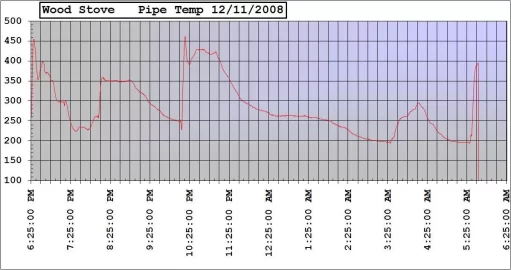

At work I have a data logging multimeter, it has a thermocouple function.
The other night I took it home and put the probe on the pipe.
Here is what it looked like.
What model# Fluke? or?
