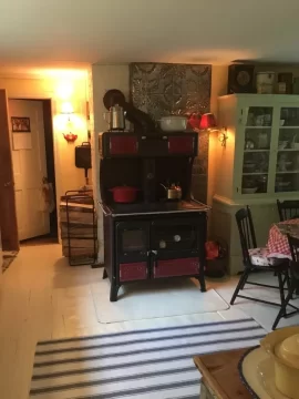

How about some pictures of your cookstove installations to help others reading this thread?
Here is a photo of my stove
  • [Hearth.com] Cookstoves
