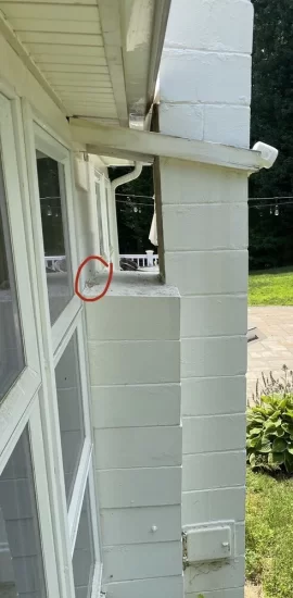

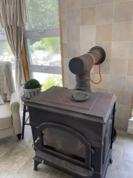

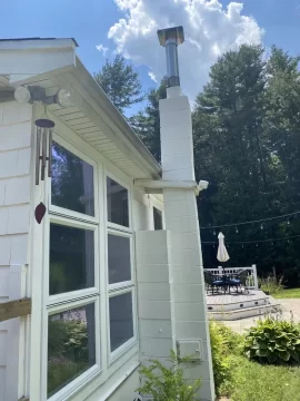

My husband and I recently bought a house with a wood stove and the first time (and only time) we tried to use it last fall it started to leak black liquid down from where the pipe and wall meet, but it leaks even when we don't use it! We've had chimney people come out and inspect it and have heard a few different suggestions that are on the more expensive side and more on how to bring it up to code. So I thought I might ask on here if anyone has had this issue and know how to fix it without putting in a steel liner. (Also our chimney has a clay tile liner and we don't plan to use this stove that often, it's in our 3 season room and is not our main source of heat.)
There are some cracks between the house and the chimney that I wonder if rain water is getting in and leaking through? We know our interior pipe is very rusted and plan on replacing it. I've attached pictures, unfortunately I didn't take pictures when it leaked dark brown/black watery liquid while the fire was going, I cleaned the wall and this is the brown stuff that since then has been leaking in. Any ideas??
