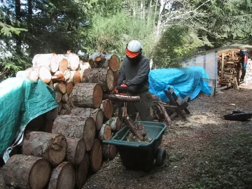

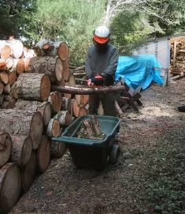

I have a big pile of limb wood that I'll be cutting to stove size with my electric chainsaw. I'm looking for the best way to support it while cutting it.
I find that if I have them supported by other limbs or bigger pieces on the ground, that bending over and cutting is tiring.
Something that's worked pretty well is to stick a limb about waist height, in between the logs in this pile, so that it sticks out. I can then just work my way from the end back to the pile of logs.

Thanks for the tips. Yes, I like the idea of having several places where you can cut, so that you don't have to cut, then shift, etc.
But my system does work quite well. It avoids having to bend down a lot, which takes a toll if you're working for several hours. Here are some photos I took yesterday:
