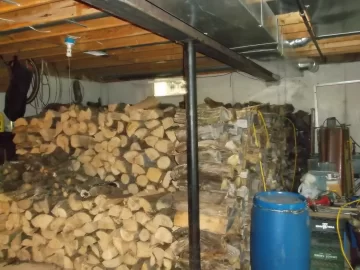

Like mentioned above, my winter supply sits in my basement all winter, until it all gets burned.
But I have some procedures I follow.
First & foremost is bringing it in while it is dry - and dry also means seasoned, not just surface dry.
Second, I don't stack it right against the walls. I leave a space between. That is mostly because my septic drain also runs along that wall, but I would do it anyway to leave room for air movement.
Third, it is on pallets. That is mostly because I stack it on pallets off the splitter, then bring them in with a pallet jack when it's time, but I would do it anyway to also leave room for air movement underneath.
All the air movement is sort of a 'just in case', just in case there is some moisture in the wood when I do bring it in. But it also helps to get the wood even drier over the course of the winter, which serves two purposes - it burns much better (of course), and also helps to humidify the house all winter.
Reactions: Cessna
That is in my basement. 5+ cord and hopefully a full winter plus!! Last year I did my standard 4ish cord and ran out due to polar vortex and never ending cold spring. 3 years and no problems so far.
I like the convenience vs. moving it a little at a time all winter. Others opinions vary.
