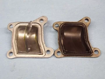

Example. I bought a new Jonsered 2166 a few years back. It's identical saw to a Jonsered 2172. The Husky versions are the 365 and 372xp. The only difference between the saws is there is a divider in the transfer port cover that reduces the power on the 2166 and 365 by roughly 1/2 hp from the 2172 and 372. The sticker says 2166 instead of 2172, and it only has the inside felling spike, not both spikes. Thats it. Every other part is the same they are the exact same saws.
The lower hp version is between $100 and $150 less depending on dealer. Everything else is identical. You can grind the divider out yourself for free or have a mechanic do it for $50 bucks ( any more than that is too much in my opinion) and then you have essentially a 2172 or 372 for $650 ( give or take a few bucks) brand new . Once the divider is ground out it bumps the power up roughly 1/2 hp.
If you don't care about the 1/2 hp difference then you can get a 2166 for $650 to $700 new and don't bother grinding the transfer cover. $650 bucks is a good deal for a professional 70cc saw that has been around on the same chassis since the 1990s and is more than proven itself over the years.
Or you can buy the 2172 or 372xp and pay closer to $850 to $900.
I went the " I will grind the cover for free" route and basically paid $650 for a brand new 2172/372 xp. This does void the warranty however.

Thanks for your response Woodhog 73. Why wouldn't someone just buy the transfer port cover for the pro version rather than bother with grinding the divider down? I get that not having to have a whole separate design and manufacturing line while still offering a full product lineup makes some sense, if one is just trying to maximize profit, and assuming that your customer base would never be the wiser. If I bought a pro version and found out I could have saved a bunch of money by just grinding a little metal off of an easily accessible part, I guess I'd feel like a sucker.Don't know. Marketing or product line expansion not sure.
