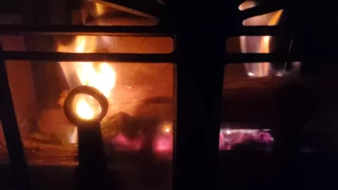

So the stove and stovepipe are up to temp.. I moved some of the wood around
Sst almost 600 stacks at like 275 the first picture is what the box looked like getting up to temp.. the 2nd pic is me moving wood around. most of it is to the back
[Hearth.com] Different burning techniques [Hearth.com] Different burning techniques [Hearth.com] Different burning techniques [Hearth.com] Different burning techniques
ok.. stove is starting to cruise..
Cat 1467.. SST 548..
I have not done anything to the stove since closing the damper ant turning the air to 1/3 after the initial loading.. eventually Ill cut the air back all the way.. Ill wait for a bit

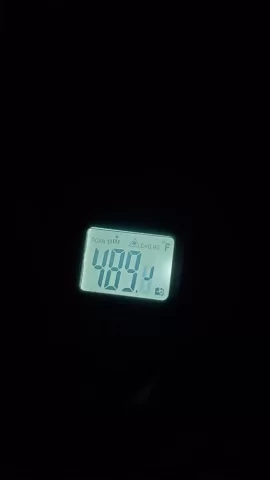

First of all, all good stuff. At what point during this burn was the first time you closed your bypass?
Also, what were the outside temps like for this start up?
At roughly 7.30am I cut the air all the way back.. cat had climbed to 1525 at some point.. when I cut the air the cat started to drop and was at 1519
STT was like 488
I cut the air back earlier in the burn only because my son and I had some fun time planned and i had left the house

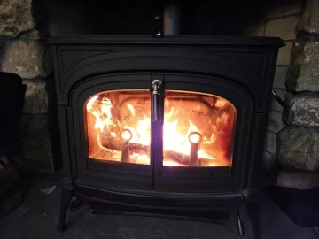

I got home and this is where my stove is
STT IS like 380.. cat is 525 and plenty of coals still going
My glass isn't quit as clean only because I turned the air back all the way earlier then I normally do.. the glass isn't super dirty but does have a little tint to it at the bottom and corners
