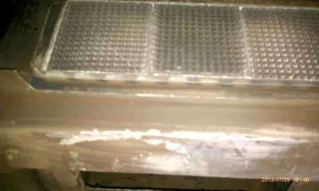

So I was doing the summer deep clean of the flue and stove over the weekend. Swept the chimney and then vacuumed every bit of everything I can get out of the firebox.
Well I pulled off the cat shield and inspected the cat. It was a nice grey color, even all the way across. I was using a nice bright LED Cree flashlight and I noticed that there are cracks diaganol across each of the three cells that make up this large cat. No material has fallen or is eroded but the light shines through these fine cracks.
I burn well well seasoned wood. No overfires, the stove has worked very well. Is this typical? Should they look new for the 10 years?
I took some pics but you can't even see the cracks.
My understanding is that cats degrade over time. You only get 100% when they are new. There will be more flaws and declining performance, but they will still be functioning. How long depends on the cat design, placement, usage. Normal life used to be more like 5 years, but some report longer.
Here's photo, fuzzy, but you can detect the cracks from corner to corner. I am not so concerned with the function as much as the physical degradation.
I have a 10 year warranty on the cat from BK.
I would contact BK and see if this is typical. My guess is that it is and you probably have nothing to worry about. But I would check with them just to be sure.

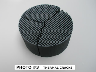

This what Applied Ceramics has to say:
What causes thermal shock to the combustor?
[Hearth.com] Do cat elements normally crack, at all?​
A sudden temperature change or uneven temperatures to the combustor's substrate can cause cracking.
One of the main reasons for this happening is refueling with wood containing some form of moisture. This can be wood that has been exposed to snow or rain, or perhaps green wood that has not been stacked and seasoned for at least one year.
The thermal shock comes when the moist smoke comes in contact with the combustor running at temperatures in excess of 1000° F (540° C).
The cell walls will develop hairline cracks and eventually pieces will start to fall off the combustor. This loss of surface area means there will be less catalytic surface space and less efficiency of the combustor.

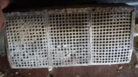

FWIW, this is what mine looked like after a little over 3 years and 25 cord.
