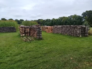

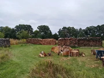

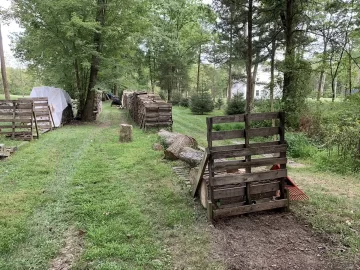

Everything here is in 3 rows of 23". Mostly oak and cherry. 3yr (summer) rotation. Uncovered, SE Wisc. Full sun, open to the wind, stacks run east-west. So far everything dries down, lights easy, burns clean.
3x23 would be close to 4x18.
Winter supply is brought in under cover mid august.
This summer I did cover some with tarpaper just as insurance against rain before being brought in. Usually we get a pretty good mid summer drought, not so much this year. The tarpaper was cheap and easy, and didn't blow around, kind of softened and molded into place.
Permanent structures would be nice, but at least here not necessary. Also, 2yr rotation might be an issue with oak, not sure, I have not tried it. I know the rain situation in philly, and bet your itching to end all that. I'm thinking under cover, 4 rows would do ok.

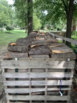

If it can get the better part of 3 years drying time you will be fine IMO. Many people do as you are suggesting, only by top covering instead of an actual roof...I think your roof plan will flow air even better, sooo...

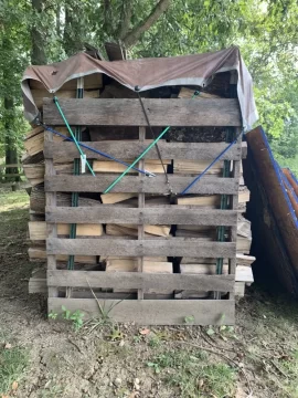

I do rows of 3 (not 4) with about 3-4 inches in between each row on pallets. 16” splits. 3 years of seasoning backed up to an open 100 acre crop field. No sun until mid afternoon but a steady breeze almost every day off the field.
I top cover the current years splits about this time of year. Do not top cover anything until then.
I think adding one extra row (making it 4) in my case like you propose would have no effect on drying. I simply don’t because pallets only hold 3 rows of 16 inch splits for me.

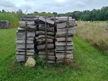

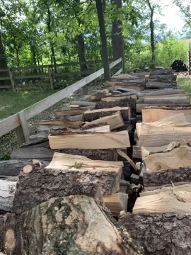

Added some photos of 2021’s splits and this years. Been stacking this way for 8 years now with good success. I think airflow in between each row is key.
I saw on a thread the other day someone mentioned using pallets as separators for each row. A very good idea I think I will start using when I start stacking this winter.

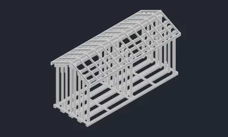

In any case, here's the shed concept. Haven't added any cross-bracing to the model yet, will get to that tomorrow. Will be building one prototype to make final adjustments, then at least a half dozen of these. Footprint is 16' x 6', with 14.5' x 6' of that usable for wood. Roof is 16' x 7' 2", for 7" - 9" overhang all-around.

Would it be floating or would you have beams connected to earth either by cemented in ground orlag bolted to cemented braces? (A question I can't seem to decide on for my own future shed)
Needs to be portable, since I’m infringing on a few zoning ordinances. Even the gravel base is causing me some concern.
So I assume when you say portable, you mean that you will be able to hook on with your truck or tractor and just drag it to a new location?

Okay guys, decision time. Ordering some lumber. Base and uprights will be in direct contact with firewood, and will be pressure-treated, but the rest is up for debate. The ridge and other eight 2x6x16' beams, the rafters, and the roof sheathing are all non-contact. Reducing weight up high would be attractive, and not having to figure out what rafter connectors can stand up to PT contact would also be nice. I'm thinking of going with non-treated lumber for all or several of those overhead components.
Thoughts?
Thoughts?
I may have missed a post on the type of roofing you will be using. But ultimately, if you’re using a “real” roofing system that won’t leak, pressure treated lumber aside from what you already plan on using would be a waste of funds and would make the structure very heavy, which you elude to.
I did just re-roof my 3 seasons room this month and would say (although it contradicts making the structure light) that using 3/4 CDX plywood for your sheathing will make a big difference over 1/2 inch. I had to remove 1/2 inch off my roof and upgraded to 3/4 and the “sturdiness” I feel afterwards is so much more reassuring.
