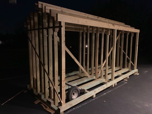

My thought is, they are also exposed to open air and sheltered by the roof. So should last a long time. As long as they are off the ground at the bottom. No doubt PT would last longer though.
Yeah. These lumber racks will weight roughly 3200 lb. when first built, and I'll be loading them up with another 20,000 lb. of oak. That'll make a dent in the earth, sitting there for three years, if anything can."But going non-PT on those components saves me a few $100’s, a few hundred pounds, makes the roof sheathing easier "
I always think of wet vs dry wood weights with firewood, but I never thought of applying that thought to PT wood. Learn something new every day... https://roofonline.com/weight-of-pressure-treated-lumber
Lay down a dozen 8x16 patio pavers under each one. I built a good sized shed, 14x20, built on a set of 8x8 beams, underlain with patio blocks as footings, with a deep gravel base. It's not sinking or floating away, plenty of frost and rain.Yeah. These lumber racks will weight roughly 3200 lb. when first built, and I'll be loading them up with another 20,000 lb. of oak. That'll make a dent in the earth, sitting there for three years, if anything can.
By the time the firewood and the racks are dried, we'll be down from 23,000 lb. to roughly 16,000 lb.

I’m thinking of building six 6’W x 16’L sheds, which are accessible from both sides, and would allow me to stack in quadruple row form with my 18” length splits down the length of each shed. In other words, four 18” wide rows of 16’ length each.
I’m doing all dense hardwoods, most often red oak, so drying is a concern. Who has experience with drying wood this way? Will 2-3 summers under roof in four rows still get the job done?
.I suspect you have less an issue with wood boring insects than we do down here, Poindexter. Even my white oak pallets succumb after just five years as wood cribs, there’s no way framing lumber would give me the kind of lifetime I need.
I went non-PT for everything overhead, which I know means I’ll be battling the carpenter bees every summer. But going non-PT on those components saves me a few $100’s, a few hundred pounds, makes the roof sheathing easier (one man operation), and means I can use some of the thousands of regular iridite roofing nails I already have.

Use #2 clean crushed stone; taper the perimeter down to grade and tamp it in place, you'll be amazed how stable it will be and it will avoid having a "step" to trip you up every ime you turn around unexpectedly.Since I’ll be stacking on the base of these portable sheds, to keep a hurricane or winter storm from taking them away, I want them to be well-supported. Ground is not presently level, but could be easily leveled with 2 yards = 16’ x 6’ x 6” + perimeter of crushed stone beneath each.
Only remaining question is keeping a base that deep of gravel in place, but I suspect 3/4” modified may compact well enough to mostly hold together. If not, I need to think about a form or wire.
I would use the standard lumber yard .40 PT for the uprights but you should know that that crap is not rated for ground contact. FWIW, if it were me and I was looking for longevity, .60 foundation grade would be a no brainer for the ground contact stuff; the .40 won't last 10 years on the ground.Thanks, guys. I think we all agree, treated below, non-treated above.
Those uprights are up for debate. My thinking was to go PT, because I want them to last 20+ years, they are exposed to weather, and in contact with potentially-infested wood. But you’re free to tell me I’m wrong!
