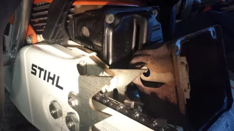

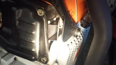

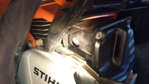

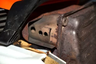

    There is the factory hole (bigger than a nickel), the second port with screen and deflector on opposite side, and the front cover is the 3rd port.
    The factory OEM muff on my 460 had the deflector. I bought a new can that had no deflector.
    Also, the factory cover has a stock opening that is smaller than a dime. Its a terrible pic and hard to tell (phone batt didn't allow flash, so I used my DeWalt light). You can see the stock port is small. The port on mine in that location is much bigger in itself. Plus the additional 2 ports, make for a Mean sounding Saw !!!
