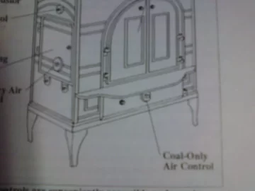

Thats what sticks was saying, The air on the ashpan isn't the primary air, it was there to use when burning coal, not wood.
Not that it really matters, but I found in the manual were it shows the air control on the ashpan door, and it's purpose.
Actually it does matter. Before I saw your picture I started using the side air damper and it actually does work quite well, so I may keep on doing it that way. I just want to mention that the only time I open any air damper is to get the combuster up to temperature and then everything is closed off. I do have an open mind (sometimes), Thanks for your advice!
